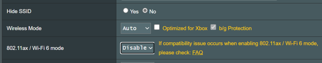

Funny thing, its only an option in the mobile app, but not on web version..
Anyway, still cannot disable WMM.
What about Wireless - General > Wireless Mode? I believe the option to disable WMM only exists if you can set Wireless Mode to Legacy (aka 802.11g).
no such option for me.

As that article I linked to says, WMM is mandatory for 802.11n and above. The only way to disable it would be to drop down to 802.11g. None of these options appear to be available in your router's GUI though. :(
Meant 802.11g ofc.. hopefully someone has workaround.., Thanks anyways!
I'm just wondering whether the Wireless Mode option would appear if the GT-AXE16000 was running as a standalone router rather than part of AiMesh.
You could perhaps try forcing it using SSH commands but any changes would likely be temporary.

Already tried factory reset both routers, never paired in Mesh - still doesn't has it (on the other hand, the XT8 Does have Legacy mode with the ability to disable WMM!).
Seem like they just removed that option.
I also ssh'd to the router and using nvram tried to disable WMM/WME manually - committed, restarted - same result (they turn on automatically)
