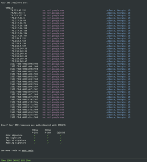

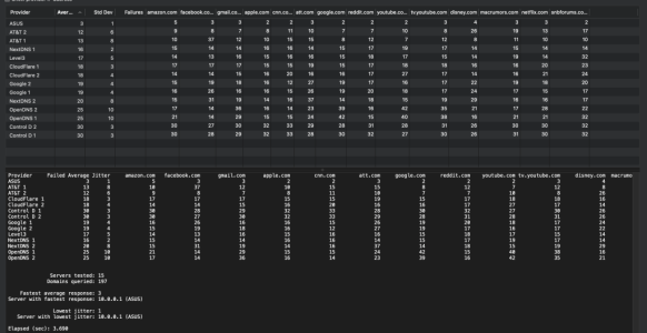

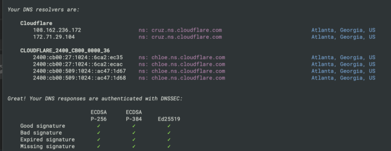

Some screen grabs of what I see. The DNS test is in order of average latency. AT&T 1 server is prone to lookup failures and fails many times.

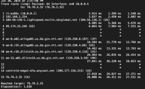

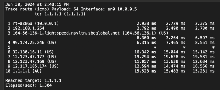

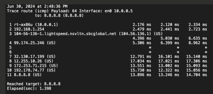

Can you provide a traceroute to dns.controld.com, 1.1.1.1 and 8.8.8.8?

Trace routes

Thanks, appears to be 2x of Cloudflare and Google, which is of course a higher absolute number, but in reality would have zero human noticeable difference. Once we add a POP in Atlanta, it should decrease latency to approx the same range.
Will have to see, but that makes sense since it seems all trace routes for me go through Atlanta. I am amazed that Nashville has so little direct peering with other major carriers, even though I know there are a few large exchanges here.
