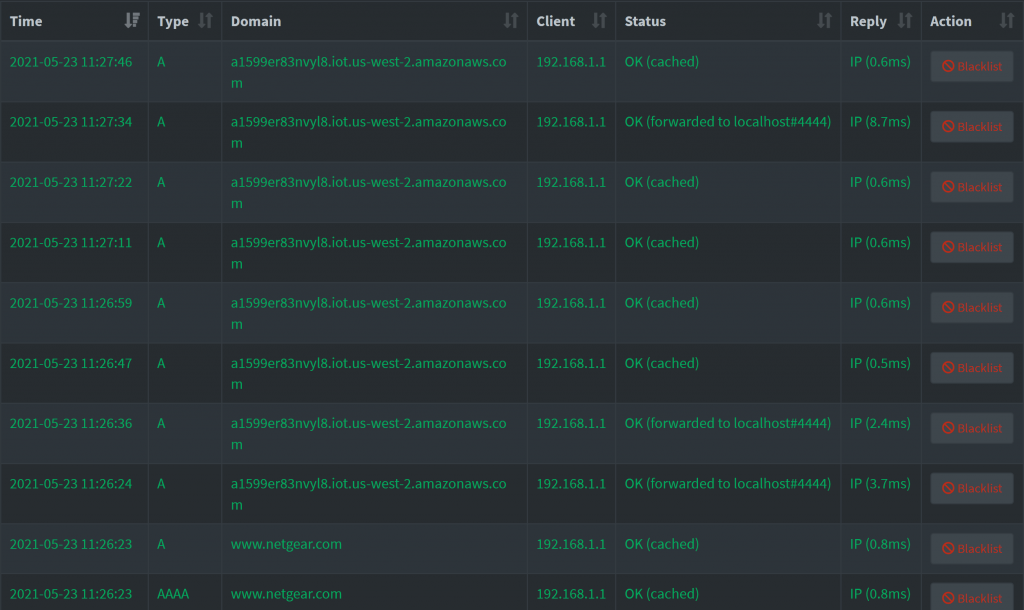

Hi, my orbi is calling home every few seconds. Should i block these on my pihole ?
no read my post above. This is my findings so far, I can not confirm or deny it. But better safe than sorry.
Just a couple shots in the dark (i.e. guesses).
Any chance you have Disney Circle, NetGear Armor, or remote admin access (via the Orbi app on your phone) enabled? I assume those services need to periodically check in.
Another possibility is that the Orbi is periodically checking in to see if newer FW is available, so that it can show the ! notification on its admin pages.
I've reset the router. Seems to be much better. Calling only Netgear.com every 5mins.
I've disabled circle, armor and remote access, previous and now.
