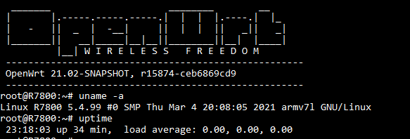

I flashed OpenWRT (21.02 branch) to try it out and the loads are drastically lower.
And, the speeds have increased a lot.
@RainGater96 This is not a thread about OpeWRT but your post is good so anyone can compare and share their results. I'm interested in your 2.4GHz Wlan speeds with OpenWRT. I personally recommend if you use OpenWRT to try the OpenWRT builds with NSS offloading too and if you want try the Master branch build too for more complete view of the performance.
@RainGater96 This is not a thread about OpeWRT but your post is good so anyone can compare and share their results. I'm interested in your 2.4GHz Wlan speeds with OpenWRT. I personally recommend if you use OpenWRT to try the OpenWRT builds with NSS offloading too and if you want the Master branch build too for more complete view of the performance.
Yes, good idea. Since OpenWRT is open source, when possible, anything working better than NG (with NSS) could be transposed into @Voxel ’s firmwares.
Why not opening a dedicated thread for that?
