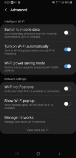

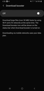

This morning I ate through two gigabytes of mobile data in like 10 minutes while connected to R7800 5g wifi. I just thought that I caught a break on my phone and things were just working (even though my s7+ tablet wasn't working via wifi). I didn't think that the cell signal extender could be the reason (since my tablet doesn't have a sim card).
I had "switch to mobile data" and "download booster" both turned off. Switch to mobile data uses "mobile data whenever your Wi-Fi internet connection is slow or unstable." On the other hand, download booster downloads files over 30 MB faster by using wifi and mobile data at the same time.
There was no "connected without internet" message on my wifi. I only found out there was an issue when I got a data overage text lol (has been a tough month with the wifi issues). You don't appreciate good internet until you get issues.
Turns out that my phone had been getting the internet from one of my two cell-phone network extenders (connected via switch which is connected to R7800 Lan port 2).
I don't know why I did not get the "connected without internet" message on the wifi connection. I know the phone was getting internet via cell signal extender while connected to R7800 wifi, but it should have told me that the wifi wasn't the source... Oh well, things are fixed now. If I see something like this in the future on a different router and go through the factory reset and know the wiring is fine, I now know I should check to see if downgrading firmware fixes the issue.
