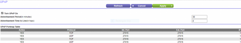

I seem to have an issue with UPNP. I can only assume this is something to do with the Router, I don't know much about how NAT works but UPNP and port forwearding all seems fairly straight forward to me so I'm not sure if I'm doing something majorly wrong here or if there truly is an issue in the firmware.
Basically I want to open a handful of ports for a game I'm playing online (quick note; it's Wreckfest, and I'm running Windows 10). I use a command line tool to do this on the PC the game runs on because I've never been happy with the R7800's port forwarding options, mainly I want to close them when I'm not running the game and to do that I'd have to delete the rule in the router - there's no on/off switch, so I have to create the rule again to 'turn it back on' and coupled with having to log into the router to do it all anyway it just makes it a bit of a hassle. The tool I use works much quicker and simpler. I run it, it opens the ports I've got set. Nice and quick.
When I run it it appears to work too. The R7800 shows this in the logs;
[UPnP set event: add_nat_rule] from source 192.168.1.3, Wednesday, November 24, 2021 15:19:40
If I go into Advanced > UPNP I can see the ports all listed too:
However the game (actually a game dedicated server) cannot see the outside world, and no one can connect to it because it doesn't show up in the server browser as if none of the ports are opened.
This is not a Windows Firewall issue BTW, I've tried doing this with and without the game added to the firewall rules to allow connections and it makes no difference. The only way I can get it to work is if I use the R7800's port forwarding option (which, as I've said, I don't want to do). If I add the ports I want to open as a rule, it works perfectly. The game can be seen in the server browser and connected to.
I did think maybe I could troubleshoot this using one of those websites that you can use to check to see if any ports are open, like canyouseeme.org, but if I enter the port into that it fails and says it's closed regardless of if I use the UPNP tool or if I just set it up port forwarding in the router so I'm not sure what's going on there.
Anyone got any clues?
The only way upnp works for me on xbox with r7800 is auto dns and auto ip. dont use any ip or dns manual on pc or gaming device if u want an open nat. Idk if this works for u. :)
I do, for the most part, let everything configure itself automatically. And everything else does seem to work fine; I've played and hosted games on consoles and the PC before with different games and they all worked. It's just this one in particular (wreckfest) which has notoriously shirte dedicated server software and you have to pretend like it's 2005 and open ports to get it to work. Just seems a bit weird how it does work if I use port forwarding and open the ports permanently in the router, but it doesn't work when I open the ports using UPNP from the PC's end even though the router shows the ports in the UPNP table suggesting it apparently pretended to open them (but clearly didn't).
I mean although I say I've played other games online (connecting to and hosting servers) without needing ports opened before, I don't know if those games even use UPNP (they may not need to, suppose it depends how they work). I have come across a post on netgear's forums regarding firmware 1.0.2.68 for the R7800 where it's claimed UPNP was broken. I'm probably wrong in this assumption but maybe if it was broken in that firmware and was never fixed, and voxels firmware inherited the broken UPNP, and it just happens that I've never had a need for UPNP until now.:confused:
It's not the end of the world for me, in fact it's pretty much first world problems. As long as port forwarding works I'll just use that. Shame there's no checkbox to enable/disable the forwarding rules.
