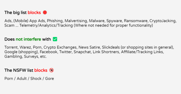

Can you please explain if the NSFW list is made from Big List + NSFW list or is just a separate list that only blocks NSWF content. If that's the case how can I have them both combined? I want to have the functionality of the Standard/Big list + NSFW content blocking.
Would it be a good idea to add to your predefined lists an option for Porn/Adult/Gore content?

They are separate lists.
The Small and Big lists do not include the NSFW list/domains.

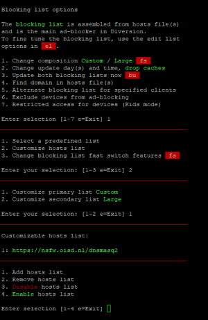

You can use both. You can do it through an SSH terminal:
AMTM>1>b>1>2>1 enter the address of your list(s), then Enter, and then I think you need to select 4 to Enable host list.
You can also do it from the WebUI: LAN, Diversion, lists the Edit custom lists. (For some reason, I’m not being shown the lists right now, and I don’t feel like rebooting, but I’m fairly sure you can do it that way instead of SSH.). Play around; you can’t brick it. At worst you‘ll just need to start over again. It is quite straightforward.
EDIT: I’m now seeing my 2 lists in the WebUI, so enter the address of the list you want to add in the box and press the green button below it. Couldn’t be easier.

I did add the list you provided me with where you specified but then I couldn't block ads anymore, just nsfw websites. I then enabled the fs option and choose the large lists. So now at "change composition" I have large/custom but only the large list works now.
I will start over selecting first the blocking list and i will reinsert the list you provided under the custom filed(deleting any other lines that might me there). Do I need to reboot the router after doing these changes or is not the case?

No, no need to reboot, just don’t forget to press Enter or Validate depending on how you’re doing it. Then come out and go back in and take comfort when you see your 2 lists there.

Disable fs where you enabled it. Then add the big or small oisd list along with the nsfw list. Make sure to paste the link that ends with dnsmasq2.
Are you saying that under "Customize lists" I should have tehm both large lists + nsfw lists? I have tried to add another line there but it only let me add only one or I just simply don't know how to add a 2nd line with the address for the large list.
This is already starting to get embarrassing as i dragged you all into this discussion and it might be just me not knowing how to do it .. I'd love too though :)
Edit: Can someone reproduce this scenario for me and maybe post a picture of how it should look like?

Below the steps to add the second hosts list : https://nsfw.oisd.nl/dnsmasq2
Thank you.
Much appreciated.
I think it looks the same with what I currently have, but mine is not blocking adult content, just ads. Does yours block adult?
It should block all the extra domains , in total now 612581 ....
