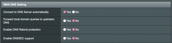

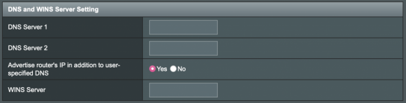

Is there anyway of bypassing a client to not use the Diversion Ad-Blocking and just use the DNS services as provided by the router (or as provided by the ISP)?
Apologies, it is a slightly long post - but I have read through the FAQs and other forum posts and the suggested ways do not work for me.
My Setup:
Asus RT-AX88U, running 386.3.2, Diversion Standard
WAN settings:
Connect to DNS Server automatically: Yes
(as I wish to use the ISP provided DNS, as these are usually the fastest)
LAN settings:
DHCP Server: DNS Server1 and 2: Blank
(so use router settings)

I have read through the forums (and FAQ at diversion.ch) and a lot of people have suggested that I set Custom (user defined) DNS 1 to 8.8.8.8 or something similar and then set my specific client Client 1 to use 'Custom 1'.
- This would work, but then I am forcing my queries to go to 8.8.8.8, while I wish these to go to my ISP instead.
- Now one may suggest that I replace the 8.8.8.8 with my ISP DNS servers.
- The issue is that my ISP assigns DNS servers dynamically, so I do not know when the ISP will change the DNS settings, so I cannot assign a value to Custom 1 setting.
Any easy way to accomplish this?
I thought setting the Client 1 DNS settings to 'No Filtering' should avoid using Diversion, but it is not the case.
