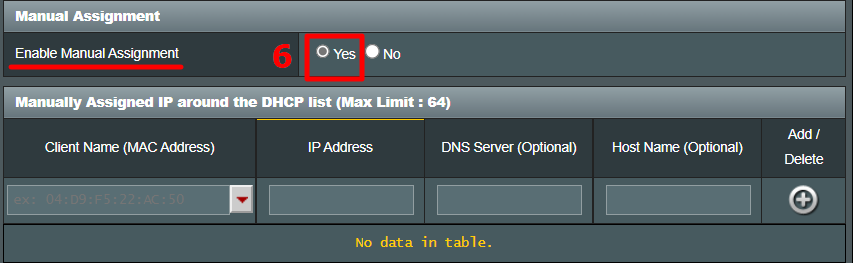

It is probably wise to either use the manual IP reservation method in the router's GUI (LAN - DHCP Server) or in the dnsmasqconf in /etc or dnsmasq.conf.add but not both (or all three).
You may need to check other settings like what you have configured for the LAN DNS servers. And the DHCP IP address scope range.
[Wireless Router] How to manually assign IP around the DHCP list?
Make sure to select the Yes option for Enable Manual Assignment.

Yes, that is set to "Yes", same is an your picture. Note that I don't have any problem with IP#'s. That works fine. The problem is the naming for DNS resolution. For example, we have several printers. For accessing those printers, we want new PC's to be able to connect to them directly, but we don't want to have to remember that a printer is 192.168.1.10 or 192.168.1.11, we want to just list it as hp.printer or brother.printer. In DD-WRT, that putting a name in the "Host Name" column would cause the DNSmasq system to use that for DNS resolution (see the top of the two pictures I posted).
Is there any way to do that on an Asus router through the GUI? If the answer is 'no', I'll just stick with doing it via dnsmasq.conf edts, but I'm hoping to avoid that.
