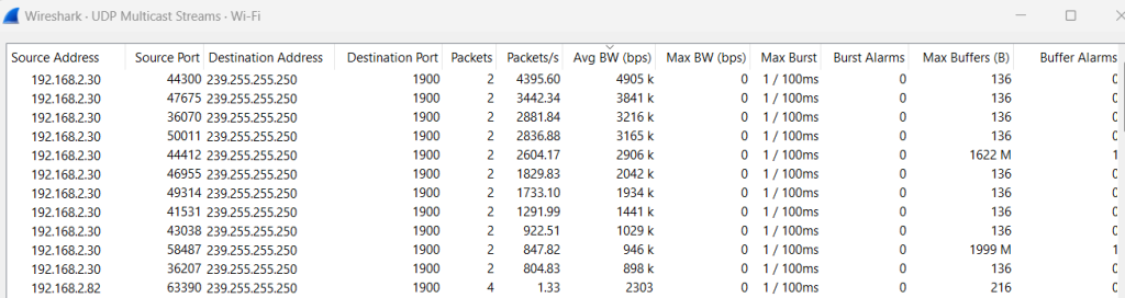

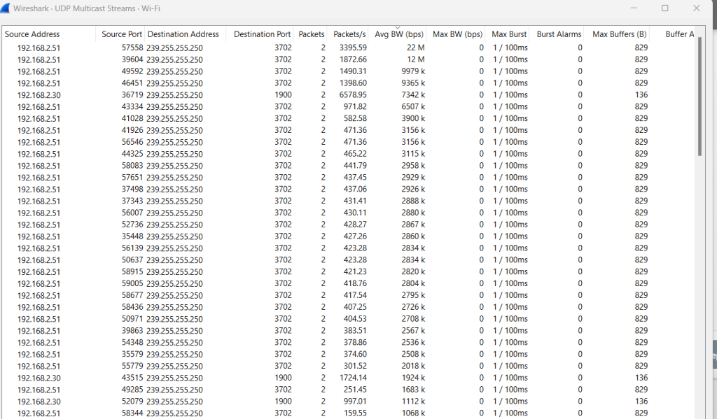

Below is a screenshot of the wireshark "UDP Multicast Streams" sorted by Average BW.
192.168.2.51 is the surveillance NVR system, 192.168.2.30 is the Home assistant raspberry pie fetching some of the video snapshots to display on its web portal. The next highest Average BW not on screenshot is my notebook running wireshark only 2301 bps a sharp dive from 1068Kbps as the next higher reading.
Is the managed switch IGPMP snooping what's helping here? traffic not seen by any device except by subscribers in the LAN? I will create a custom VLAN just for this device later to make its effects even less to others. I"ll see if Fire TV cube can just be plugged in the managed switch without video pauses.
The buffering symptom is the worst symptom in my network, it's managed by custom vlan scripts inside the RT-AC68u. I don't believe the Iphone issue is related to my network setup. The extreme attention I'm giving my network is because every 2-3months my network goes down , when that happens I have to login to all the access points and run "service stop_mdns" for network becomes functional again to my entire house. I think that shouldn't happen anymore with my managed smart switches placed between RT-AX88u and my RT-AC68u access points and the switches using IGMP snooping now and VLAN setup.

For the NVR, 239.255.255.250 is UPNP/SSDP, it is similar to MDNS and the device is advertising its capabilities and potentially also asking your router to open ports for it. It is known that IGMP snooping interferes with UPNP especially if there is no IGMP router managing membership. So that interference could explain the reduced traffic you see when plugging it into your switch.

The surveyance video stream was being sent from multiple Cameras on a POE hub to a computer running blue-iris, I'm in the process of retiring the Lorex NVR it was still connected. when the POE hub is connected to RT-AX88u, the context switches on RT-AX88u jumps by 2000. Connecting to the managed Switch instead without VLAN setup and removing the Lorex NVR from my network, context switches still jumped by 1800 on the RT-AX88u. Finally creating a new VLAN 300, placing the Blue-iris computer and cameras to the same VLAN 300 with PVID=300 help eliminate the entire 2000 context switches from RT-AX88u. That last part I also removed Home assistant receiving any feed, it seems to use resources even when I'm not viewing its web portal page. Wireshark did see both the blue IRIS computer and Home Assistant using high Bandwith MBps and no other device had Average BW bps above 1435bps, so IGMP snooping is working there, but it didn't shield the RT-AX88u from the 2000 context switches. traffic was going through the RT-AX88u rather than bypass it even when I plugged in the cameras to the managed switch with both cameras and blue iris computer being on the default native vlan 1 (no tag). My managed switches are just layer 2, they don't know ip addresses, they know vlan pvid, so vlan 1 which doesn't have a tag doesn't know how to bypass the router??.
So the impact to the RT-AX88u high context switches is the UPNP feature of the router constantly being asked to open ports, interesting, thats why wireshark saw so many 239.255.255.250 from the same Lorex NVR with different source ports but same destination port 3702. Right now only Home assistant is still left using High bandwidth, even though I disabled cameras from its portal. it is also using UPNP/SSDP. 192.168.2.30 is Home assistant, followed by wireshark on my notebook.
