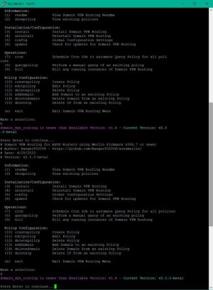

SSH UI still shows that I have version 1.4.
Reread the message and read considerations in the Original Post, if you don't enable Dev Mode then your update channel will still point to production update channel.
