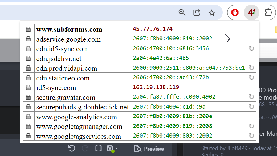

I use IPvFoo plugin in Chrome to help with that.

7 Posts above.... if the app has a corresponding website, you can use chrome plugin IPvFoo to determine associated domains accordingly.
Thanks for your answer. I read that, maybe I should have stated that. It doesn't really help as the apps on the Apple TV seem to query other domains.
Only other I would know is Wireshark with a NIC in monitor/promiscuous mode. Launch the app, then watch wireshark (look for AppleTV ip address) and see where it is connecting to. It's a bit more beyond the scope I can teach and I do not recall if wireshark captures domain names, I think it only does IP addresses. Then a reverse ip to domain lookup maybe. Alot of work.
