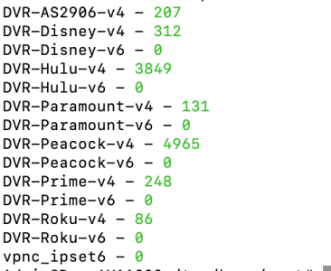

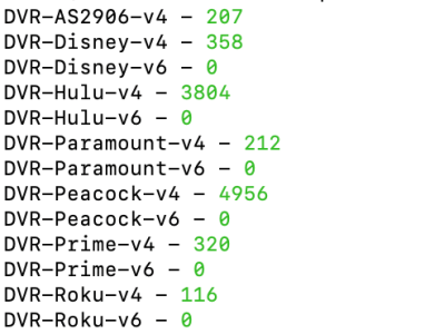

So question @Ranger802004 I'm noticing that my GT-AX11000 Pro running your latest beta script and running 3006 codebase firmware is displaying when I run the terminal command liststats -> vpnc_ipset6 ... I don't know what that is ? If I go to my GT-AX11000 running merlin 3004 codebase and your latest beta of the script I don't see vpnc_ipset6 listed when I run liststats in terminal... Is this normal ? Do I need this ?
I’m not sure what is creating this, please open a GitHub issue so we can investigate.
