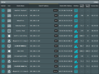

Another cosmetic change I have noted is related to the network map:
The space for the clients name seems shorter and the space for the client IP address seems wider than before (maybe is this the reason why some people has overwritten names?).
