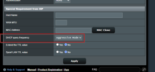

That may have to do with how the DHCP Querying is configured on your router, a little outside of the scope of this script but try playing with the different modes. Under WAN Settings.
Well thats what i mean, asus wrt dhcp was set hardcoded at like 1min or something, and that screwed up the timing with starlink. If I can ill find a link, not that it matters. I spend time on IRC #asuswrt and st users were having major issues before i even got mine.
What about restarting the WAN interface for Starlink? I updated my prior post with a new link to beta v1.4.6-beta.
You mean restarting eth0, which is connected to starlink? Ive done "service restart_wan_if 0".. doesnt seem to do much when it gets in that situation. I did not try to actually take take the interface down and up at that point.
Try changing your DHCP mode to continuous and see if that helps.
ill try, but it literally takes ST 15 minutes to come up and give the proper ip in this situation (total restart). So im not sure what that would fix.
