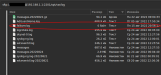

Yes, I checked, the log is empty, the monitor is silent. I wrote it like this CUSTOMLOGPATH=|opt|var|log|failover.log.

I only made sure that they are not there in the specified file. Aug 24 09:29:08 router wan-failover.sh : Debug - Custom Log Path: |opt|var|log|failover.log only says that this setting is registered in the configuration, but not that logging is being conducted.
The setting doesn’t change where your logs go, you would do that in Scribe, it’s for those who have a custom log file set up for their script. They can specify the path for Monitor Mode

The script calls the system logger like it is suppose to and you can designate a custom log file for it using Scribe and then set that same log path in the config file for monitor mode.

I don’t personally use Scribe but I have had others do what I just spoke of on having the wan-failover logs go to a custom file from Scribe (I believe) and used the new option to point the monitor to that specific file and confirmed it works.

It definitely DOES work IF you have scribe/uiscribe set up correctly, which may be your problem I think and is “outside the scope of this thread”.
