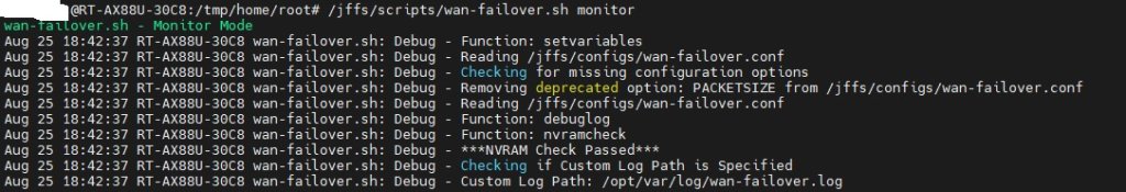

Did you verify the logs are going to the file you specified? Perhaps you could open the file and verify there are logs being generated in it?
Of course I checked, it's empty. Let's close this topic so as not to annoy other users who have it working, otherwise they will perceive it as negative criticism from my side. Thanks again for the help.

Ok @lbtboy, you have to get Scribe properly configured where your logs are going to that file you specified (This is a function of Scribe, not WAN Failover). Once you get the logs going to that file properly the CUSTOMLOGPATH Option in WAN Failover should read that file for logs when using Monitor Mode. I'm not asking for praises or anything of such, if there was an issue with my tool I'd like to resolve it and I'm sure you are aware of this from our previous interactions, however, as stated before with this particular case you need to have Scribe properly configured before proceeding forward on testing. That's not an opinion that is the 3rd party tool you are using for log management on your device and it is what you use to manage your log files, my script doesn't manage your system logger, I simply added an option for you to monitor a custom log path if one is properly configured. If your log file is empty that means Scribe is not forwarding your logs there as desired.
I don’t understand a little what is at stake, but scribe works for me, I didn’t have to specify the path to the log in the script.
p.s. I sort of understood. This option is needed in order not to write the log to another place, but for the monitor mode to see the recorded log
p.s.s Yes, it's true. Until I wrote down the path to the config new path to the log, the monitor mode did not work. Now works. Why does it keep saying "Removing deprecated option: PACKETSIZE from /jffs/configs/wan-failover.conf" ? I no longer have such a parameter in the config.

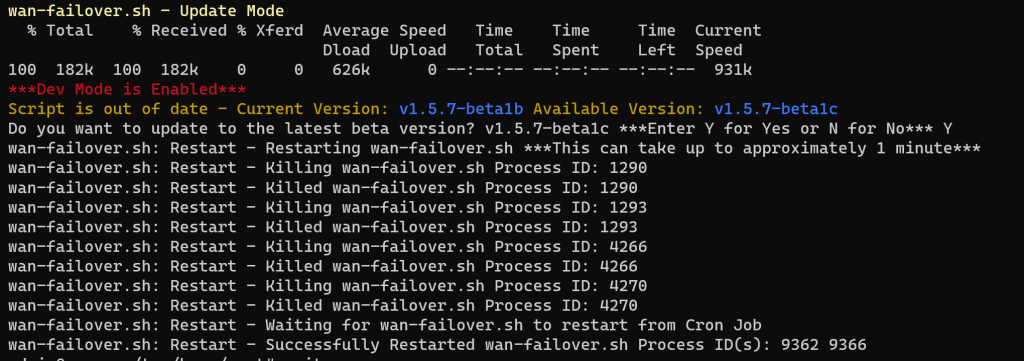

Hi Ranger802004,
I didn't tested for a while, even I did updated on every update and thank you for all improvements.
I did a update to v1.5.7-beta1c too. I did a restart of RT-AX88U router.
I switched off the modem of Primary WAN (PPPoE) and status of Secondary WAN (4G USB stick) became for few moments Disconected or for a few moments Hot-Standby but never Connected.
Could you please take a look?

When you unplug the device it probably disappears as an actual interface and that’s the reason for the error. I have logic it in to handle this for USB Devices they are unplugged but this is a little different for PPPoE so I’ll have to make some revisions.
On initial start after update, it re-enabled QoS on my primary WAN0 connection although config says to keep it disabled on WAN0.
Do you have logs you can forward for me?
I would like to add that some versions ago it worked when tested the same.
For instance I rollback to v1.5.6-beta14b and no issue found doing the same test.
