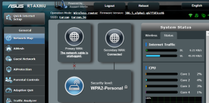

I am a noobie to this board. What a smart sounding crew here. Regarding ASUS dual WAN: I have a RT-AX88u, and what a fantastic home router. I want to enable Dual WAN for: AT&T fiber (300/300) and Charter cable (400/20). I have done a little bit of testing prior to getting Charter using a 4g BU, however that just involved unplugging the cat6 from ATT router into ASUS router. It seemed to work fine. HOWEVER, what I think I am hearing here is that when it's not simply a physical disconnect, the ASUS dual WAN doesn't really failover consistently. (I am only using for failover, not loadbalancing, which sounds problematic). Is that correct? What should I use for failover rules? Right now it's 3 fails each 5 seconds. (Failback is 40 tries). It's using the default ping and DNS query. What is best?
Is this going to work? Should I go buy the microtik router and put in front?
Thanks in advance.

What settings do you use for failover and fallback?
This is correct. If you really need reliable and fast Dual WAN failover/failback, Asus home router is not going to work for you. I currently have 4x Dual WAN networks - 3x using Cisco RV345P routers and 1x with older Cisco RV320. Other cheaper router options are available. The user who replied to you first can't help you and the users who think it's working test with unplugged cables. I don't have an USB modem to test with, but I've spend hours with WAN + LAN settings and nothing gives satisfactory results. Test your luck and see what works for you. Browse SNB forums for Dual WAN issues. Many threads.
