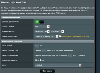

Hmmm asus watchdog for switching between primary and secondary wan is not reliable at all. Now my primary line is down but it didnt switch to secondary i dont know why. And i cannot see the log because i am not there.
May be it is possible to add some mechanism to the script that can constantly ping 8.8.8.8 through primary wan and if ping fails - then check if asus switched to secondary. If it didnt - then force switch. And back for failover.
As far as i understand - its not too complicated but will help a lot those who suffer from asus' dual wan switch mechanist that works like sh"t.

UPD. Primary wan got back to norm and i managed to teamviewer the router's log. It even didn't try to switch from primary to secondary wan because it didn't see the problem. Watchdog is enabled, dual wan is enabled, ping to internet and failback are enabled and so on. But the router even didn't see that primary wan was down. So 2 questions:
1. May the script somehow interfear asus' dual wan switch mechanism? Not the one which works when you unplug network cable but the one that pings smth and swithces to secondary when primary is down.
2. Does anyone have the same problem like i do? Asus' dual wan switch mechanism is not reliable at all.
It means that it would be great to add some lines to the script that could check if asus did smth when primary wan got down or no. If no - then fix this. And after that - help with failback as well.

I have seen the same behaviour, with the same settings for watchdog as yours.
Say, my Asus is on wan0, wan0 is connected to router0 with internet, wan1 to router1 with internet.
Then I unplug the wan cable on router0, you'd expect Asus to switch to wan1 within the watchdogs ping timeouts.
But no, it stubbornly stays on wan0 even though the pings must fail.
This happens on Merlin as well as on john9527 fork.
I find it concerning that such a simple function does not work reliably.
Do I really have to make a shell script that watches the watchdog and do it's function when Asus is unable to provide this service satisfactorily?

P.S. By the way - when i unplug primary wan cable - router switches to secondary within ping time. So problem is only with ping to internet function, when primary wan cable is physically connected, but ISP is down because of some weather or other problems.
I noticed the same, dead or unplugged works right away but not if internet connection is lost.

When is the last time you tried my fork? I touched the 'third rail' and did a bunch of wanduck changes in V23 working off-line with someone on dual-wan and got things pretty well working (at least for him).
One thing on my fork....make sure you set "Redirect to error page" to LAN or WAN down if running dual-wan. It turns out that setting has additional meaning in a dual-wan environment.
