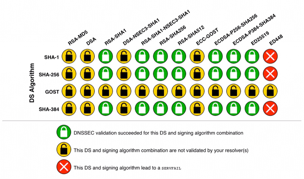

Both were tested using google
Yea I cannot get green's on ED448 row for the life of me on DoT or on normal with cloudflare, I don't know what I am missing as far as these results you have for cloudflare, Quad 9 does give green though.
Google DoT is iffy, sometimes it wants to play nice and sometimes it wants to splat red/green/yellow every where. Google normal servers plays nice.
Interesting, i changed the DNS to Cloudflare then cleared the cookies etc on Edge, Chrome and Firefox then run the test again on each browser and got the results you mention
okay I wanted to make sure I wasn't going crazy,
cloudflare seems to be the only one that has red on that row, it must sign those differently than quad 9, or google, or any of the other ones. My isp by far gives me the best results.
When you say your ISP gives you the best results, can you explain that setup? Is that without using DoT/DNSSEC? or with it?
Without DoT, cable internet. BTW so far all DNS servers tested pretty much match their DoT counter parts (eg. cloudflare, quad9, Ad Guard, Clean Browsing), but the only exception I have ran into is with Google basic DNS server v.s. Google DoT.
Yeah, seems that cloud flare does not support that cipher(i might be wrong)! And i don't know if its a region thing or not! Here in Brazil using cloud flare i get the same result:
