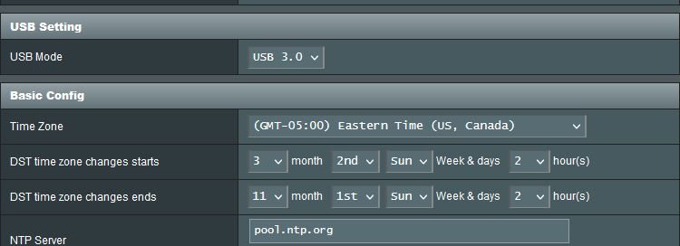

No, there is no setting in the Asus RT-AX86U_Pro : 3.0.0.4.388_24198-g380c137 firmware for HDD hibernation.

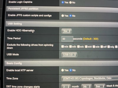

As a datapoint. Its there for the RT-AX86U Pro running the Asus-Merlin 3004.388.4...
