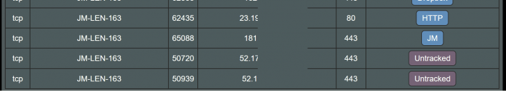

hello @dave14305
I have 2 custom iptables rules at the very end. They are called JM_VPN_1 and JM_VPN_2.
When looking at the tracked connections, i see JM_VPN_1 but with a different name: JM
hello @dave14305
Yes, I see how that can be a problem, due to another trick I was using before implementing custom rule names. For now, just remove any underscores to avoid the bad parsing, until I can fix it. I think the same would happen for all your rules with underscores, where only the first fragment is displayed.
