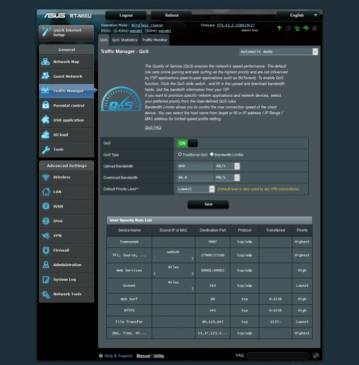

Hi, with the beta I only get stats on downloads not uploads - see below:
Do you really want your upload bandwidth capped at 800 Kb/s? With the rounding problem in the current beta it may take a little while for some data to show up with that setting.
EDIT: BTW...nice set of rules. Only suggestion I might have is to put the DNS rule at the top of the list (I know it's a pain to have to delete and re-add everything, it's on my to-do list :) ). If you are comfortable with the command line, you could edit nvram qos_rulelist to move it.
Ah OK. That's cool - if its because of a known issue, great, no rush. The upload bandwidth is right - we don't get much down under :(
Thanks. I'll try moving that line up.
