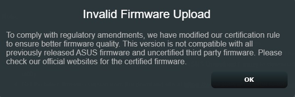

I am getting an error when trying to flash my ASUS RT-AC66U B1
https://gyazo.com/136d535ad0f32282c47da9067953a087
See the installation instructions in LTS_OVERVIEW.pdf
For supported routers currently running ASUS firmware 380.3000 or above, or Merlin 380.60 or above, you cannot load this fork using the built in firmware update web interface. You must use the ASUS Firmware Restoration Tool from the ASUS support website or the built in CFE Mini-Web Server to install this fork firmware. You must always perform a factory default reset following the firmware update when moving from ASUS OEM or Merlin firmware above level 374 regardless if you updated via the web interface or Restoration Tool.
I cannot find the restoration tool for this.
And how do i access this "built in CFE Mini-Web Server" ?
Found it here:
Asus.com seems to have diffrent webpages, the US one did not have any software of any kind at all.
