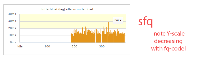

Has anyone else test FQ-Codel against SFQ ?
I get a significantly faster RAMP to max speed (a signature trait of CoDel) compared to sfq.
My bufferbloat is +5-10ms above average.
These two things imply to me that it is working as expected.
The only weird thing is that a have a 1sec burst of bufferbloat for the first second when the dslreports speedtest is starting (other users have reported that it doesn't happen to them).
I will post gif results of before/after.
Edit:
