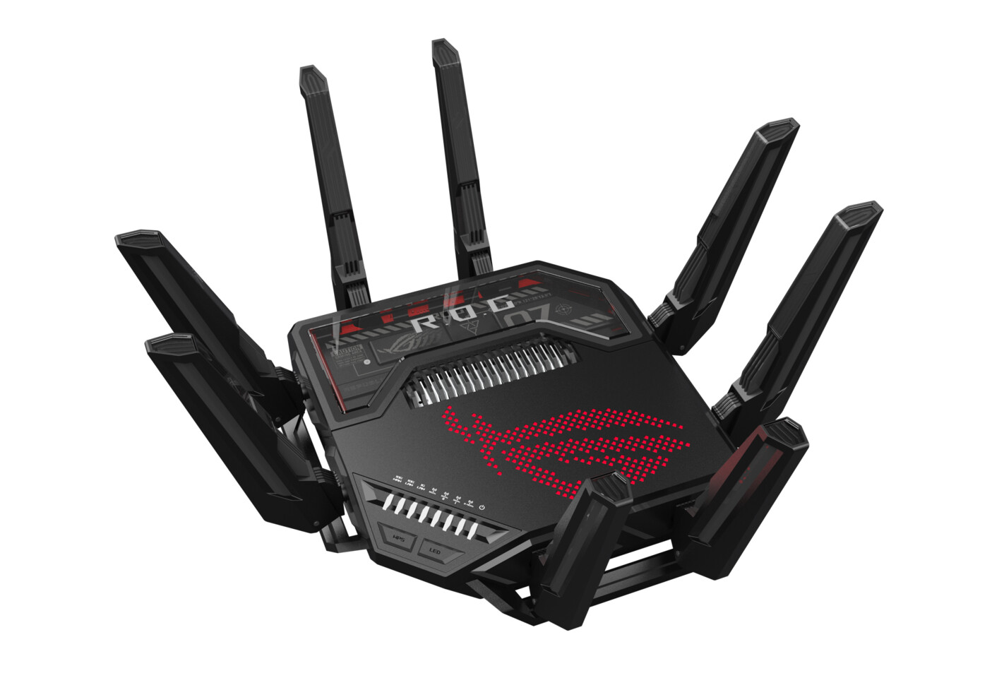

GT-BE98 WIFI 7
The blue light can be turned off. The idea is someone is already offering unobstructive and bendable. One of the reasons Ubiquiti has a large fan base - you can customize the setup and make it your own. Attention to details is important. When you pay $700 for the latest and greatest and you see this below makes you wonder was your choice a good one.

The biggest thing besides clients is the physical port speed being the bottleneck even at 10ge you're at 25% of the potential bandwidth
Agreed. Like on the AXE16000 where I was only able to get about 2.6Gbps wired upload/download speeds with AiProtection turned on vs 8.9-9.1Gbps on the RT-AX89X with the same features enabled.
Additionally, with more powerful specs of a Quad-core 2.6GHz CPU, 256MB Flash, 2GB DDR4 RAM for both new routers, hopefully port speeds won't be throttled like in the AXE16000.
Its a fail, I want min 10 antennas, better 20 when thinking of it :cool:
Could you help the ignorant and explain the math? What interface has 40Gbps capability? These are theoretical numbers you are talking about? Is this to take advantage of consumer ISP service or LAN disk-to-disk?
@Justinh
BE has a max capacity of 40gbps
AX single 2x2 client hits 1.5gbps / BE single client should hit 3-5gbps
So, if you have 2 wifi clients maxing their potential then you're going to drop their rates when wired clients take precedence over wifi for traffic priority unless you specifically make wifi a priority over wired.
Looking at the bandwidth settings at 80/160/240/320mhz you can see the scale of clients total bandwidth being shared per allocation. Assuming 80mhz / 10gbps which the router will do you're limiting your clients to the least possible bandwidth. However, if things play out the same way as AX and you get 70% of the link rate which is where I get the 3-5gbps number from by doubling AX LR/actual bandwidth to 320mhz channels.
Now, the other thing that's a bit unknown right now is how Intel and others will configure client adapters and whether there will be additional bandwidth tech rolled into BE adapters like they did with DCT to get up to 1.5gbps with the AX411. If there's some bundling of bands into a single pipe like DCT does there might be additional BW available to a single client.
Anyway, so, hopefully you can see a single 10ge WAN / LAN port won't be sufficient for maxing out the connection to its fullest potential. Now, on the consumer side a 10GE ISP connection might not be the norm unless you happen to have a fiber connection and the pricing is low enough to make it tempting enough to purchase. There are some pockets with co-op type ISP setups that approach the 10GE speed threshold for ~$100/mo or less.
Internally on the LAN though hitting those max potential speeds would require some better HW / SWX / AP with appropriate physical ports to not bottleneck the connection.
