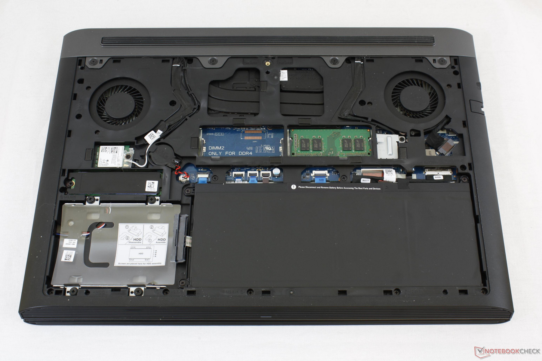

It’s quite easy, as soon as you take out the bottom plate/cover of your laptop, you should see the WiFi card held in place by a single screw. Just detach tips of the black and white wires from the old card and take the card out. Insert the new card and connect the black and white antenna wires to the their respective color coded receptacles which are marked on the card it self. I can post images/guide later if you want.
Pretty much most old laptops up to around 2014-2015 use standard half mini pcie cards (ie 6230n, 6300n, 7260ac) and current gen laptops generally use M.2 (ie 7265ac, 8260ac, 8265ac, 9260ac)

Vast majority of laptops you only have to take out the bottom plate in mine it’s only one screw at worst maybe 6-8 screws on some. Most Dell’s and most other laptops in general aren’t like the one in that video fortunately.
Below is an example of my model (Inspiron 7577) when I meant simple :), most should be somewhat like this. Most Latitudes and Precisions should also be pretty simple, at least the ones from the mid-late 2000s onwards.
