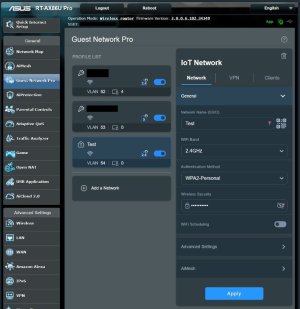

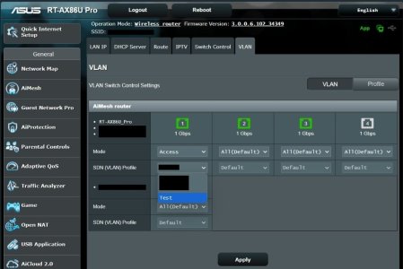

Working for me on a RT-AX86U Pro running stock Asus 3.0.0.6.102_34349 firmware. Created a "Test" IoT Guest Network Pro preset entry then went to the LAN > VLAN page. Set one of the LAN port Mode to Access, then in the SDN (VLAN) Profile field both my existing Guest Network Pro "Custom Network" presets are listed along with the "Test" IoT entry. See attached examples.

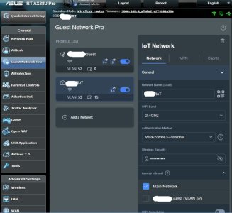

What do you have on these screens?
esp. Advanced Settings.
Also, what do you have for the Drop Down "Access Intranet"?
k.

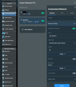

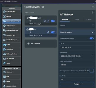

these are my native settings that currently work fine with wireless clients. i have since deleted my "test" profile but can easily reconfigure.

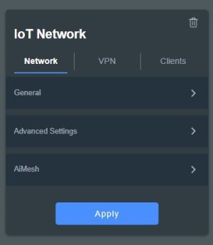

What is on the Advanced Tab please?
Each VLAN Profile under the 'GNP' Tab has three horizontal sections (Tabs) and some slightly hidden drop-downs I might add, esp the Access Intranet drop down but that is an aside.
The 3 horizontal sections are General, Advanced Settings and AIMesh as shown in the attached. What is on the Advanced Settings one?
If you click the DOWN arrow on General to "minimise" it, you should see the other two tabs; which you can then drop down.

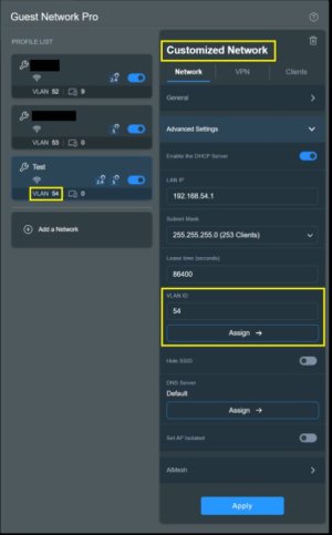

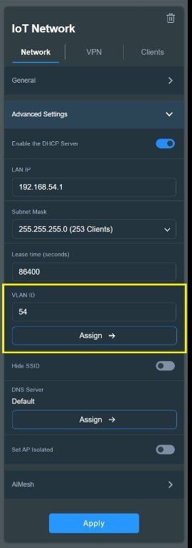

Post a screen shot of the Advanced Settings section of the IoT VLAN you have created (redact any sensitive information). Example of what mine looks like attached. The VLAN ID number was auto generated by the router GUI in my case.
Strange. After some further testing using the router's GUI. Deleting and adding an IoT Guest Network Pro preset several times, the IoT entry suddenly stopped showing the VLAN ID number both on the Profile List and in the Advanced Settings for the IoT when it was created in the Guest Network Pro section. I assume this is some sort of bug in the 3006 firmware.
Using the Guest Network Pro Customized Network preset works though and a VLAN ID number is shown. So this may be the workaround if IoT doesn't show a VLAN ID, use Customized Network instead.
Rebooted the router and creating a IoT Guest Network Pro entry still doesn't show the VLAN ID. Tried a different web browser (Edge), same issue, VLAN not shown for IoT. Tried using the Asus mobile app for Android, same issue, VLAN ID number not shown when creating an IoT preset Guest Network. Weird.
Edit to add: If people experience this issue (no VLAN ID with IoT) they may want to use the Administration > Feedback form to submit a bug report to Asus.
i believe you nailed it here. when using guest network pro>customized, a vlan id is now created; also, the lan>vlan profile page is populated with the new test entry (attached). as a result, i'm much further along. i will now look to see what i can do with the wired client. i will report this behavior to asus.
