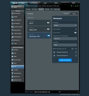

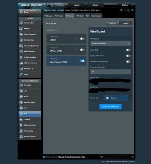

Thanks for the GUI images.
As before, the rule is there, but there's still no indication of any attempt to route traffic through the WG tunnel and into the local network. You are trying before posting these dumps, correct?
I connected the client before dumping. Should I have connected the client while dumping?
What I want you to do is attempt access of the LAN from the WG client so we can see if it enters the router via the wgs1 network interface and gets blocked from accessing the LAN (br0) by that rule. If that happens, the pkts count field on the rule should be > 0. But as it stands, I can't tell if it's 0 because you never attempted the access, or you did and it's bypassing the rule for some unknown reason. Normally blocking inbound access from VPN servers in this way is pretty straight-forward. We do it all the time. So it *should* work.
