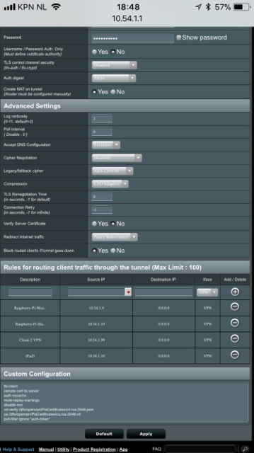

Thanks for the great tutorial. I have been abroad for a few months (without internet), I came back and moved to a new appartement with cable internet and router. I have them on different subnets. Internet does work. Unfortunately I am still having problems starting my VPN. For some reason it does not route through it when I try ipleak.net.
I have no idea what I did wrong. I am trying for 4 hours now with different settings :x I added the pictures of my settings and the log when starting up (I cleared it before).
Thanks in advance :)!
Additional: can it be that ipleak does not work because my (first) cable modem/router is without vpn? Or actually it should not be a problem because when I use the client on my computer it does work.

As a reply on my own inquiry:
After a long search of different methods I found out that my provider works with IPv6 protocol. I was not able to turn on DMZ either. So I called them, they turned IPv4 on and I was able to activate DMZ for my second router (Asus RT-AC68U).
Speed is very slow but VPN works.
Now I am trying to figure out how to speed up the network, but that is a different discussion all together.
