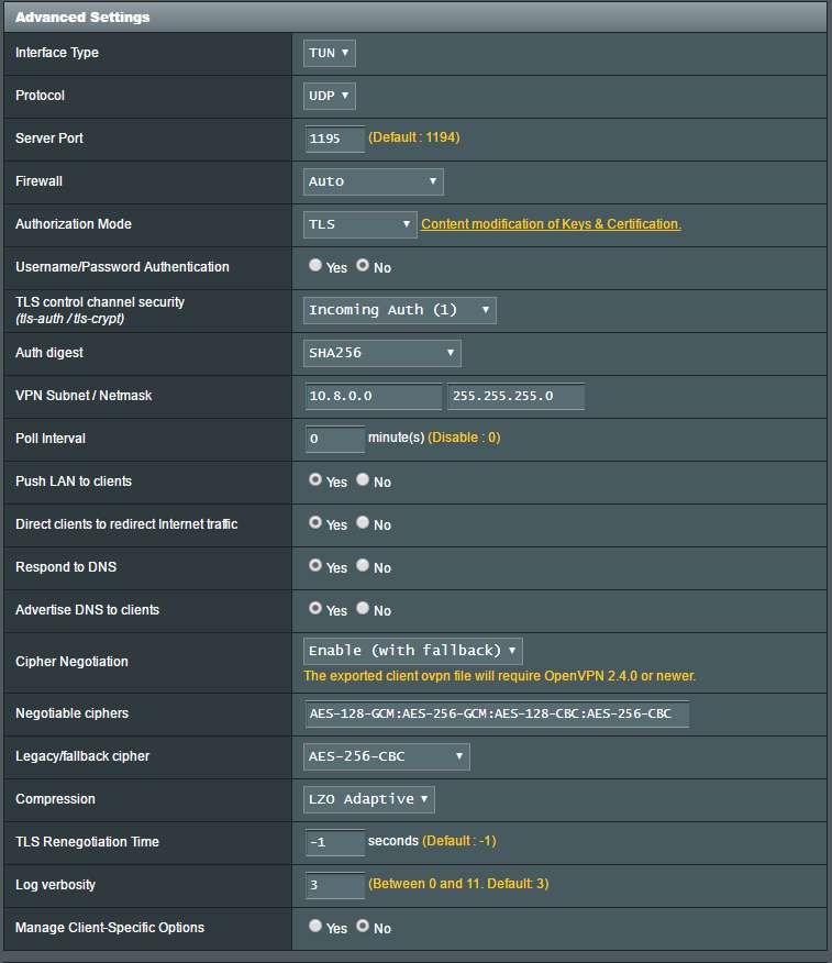

Thanks! I did make those changes to upgrade security from password only however I still cannot connect to a local machine. I am using an ip so can't be a DNS issue. Within my local network I can hit the 192.168.1.5 machine from 192.168.3, and both are behind PIA. But when I connect with my cell phone to this OpenVPN server, it connects properly, but I cannot hit 192.168.1.3 from the assigned 10.8.0.2. Is there a manual route that needs added to connect the two?
Can you draw up a simple network diagram and post it here?
Figured it out... Looks like the issue was the router itself was in the PIA VPN policy exception list so I could connect to it on the WAN with PPTP (legacy), otherwise PIA VPN blocked it. I took it out of the exception list and now everything connects! Thanks everyone!
Try changing "Respond to DNS" = Yes.

My setup as per attached works for accessing computers not behind the PIA VPN but not the ones on it.
I also have ncp-disable in the custom area, not sure if this is still needed or not

I am trying to get OpenVPN server running on a Asus DSL-AC88U
I can connect to the vpn server and client given 10.8.0.2 ip
Local subnet is 192.168.2.0/24
However I cannot access my local NAS or NVR when connect via VPN
A few screen shots of my config to help trouble shoot.
I'm configured to TCP 443 at the moment as UDP1143 won't connect
Try setting firewall to Auto and compression to LZO also go back to TUN UDP 1194
I would also try it with AES-128-CBC

Hi Yorgi,
Thanks for helping. I got it up and running eventually with your help on UDP.
Only difference was I had to set firewall to external only.
Think this maybe due to Asus DSL-AC88U having inbuilt modem.
Screen shot to help others struggling to get OpenVPN running on this new model.
