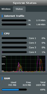

Of course I tried to find that bottleneck with htop and atop, here are two speedtests performed on computer connected via ethernet - first time it used four cores, secondly two. On atop bcmsw_rx has highest cpu usage but still around 90%, I made one more test with skynet off and from router itself - can't see any difference in cpu usage except ookla proces and of course +150Mbit
If you're seeing >1% load on bcmsw_rx when testing from a LAN client* that means that hardware acceleration is at least partially disabled. As bcmsw_rx is singled threaded this creates a CPU bottleneck and has a noticeable effect on high speed internet connections like you have. This has been commented on before in these forums.
I can't guess what is creating the problem in your case. It's usually things like AiProtection, QoS, etc. I don't know whether any third party scripts deliberately disable hardware acceleration.
* Ignore speed tests done on the router as they are unreliable because of the CPU issue.
