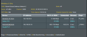

I posted my devices on 2.4 which has been solid no drops there now here is 5Ghz.
The device starting with the 56: is my Galaxy S10 cell phone which goes on and off the network as I leave the house.
The device starting with 50: is my work laptop which pretty much stays stationary until I'm in office Tue and Wed I work from home the rest of the week.
now that the week has started I will be on the work laptop alot more so will monitor it for connection drops but I haven't noticed anything so far while working in the last 10 days.

Here is a screen from my work laptop that has been connected in 5 Ghz (auto channel, everything by default) since 07H00 today without any problem.
I turn the computer on early in the morning and turn it off at night when work is done. I have been doing this for over 11 days now and no interruptions.
I also have android smartphones that connect and stay connected for more than 3 hours (when I watch youtube) without any problem.
Solid as a rock.
