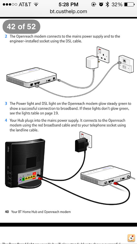

Ok that's very helpful, I think we're on to something. Just so I'm totally clear, you only have the BT Openreach modem, not the "BT Hub" as well? (Depicted together in this picture)
That's right, just the BT Openreach Modem plugging directly into the N66U. Pretty much like the bottom diagram you've provided but replace the HomeHub with the N66U :) I also have a Synology DS213j plugged into the N66U too, the web interface on this can be accessed with no delay at all.
