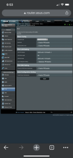

Thanks again for your help. My ISP was able to put the provided modem in bridge mode and now IPv6 works on native. One final question. Do the setting attached look correct or is there anything I should change?
The attached screenshot is too small, but looks like you've got IPv6 address assigned to your router. Now be careful with IPv4 DNS filtering services and VPN clients. Your devices may/will go around them using IPv6. That was the reason I asked you why do you want IPv6 enabled. It makes network management harder and anything IPv6 related in Asuswrt-Merlin you have to test yourself. There is no performance benefits in using IPv6.
Thanks for the info. Since there are no performance benefits I will probably disable IPv6 now that I know it at least works.
