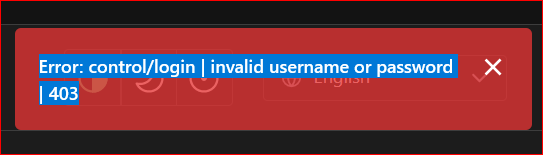

regarding "AdGuard login" - username & password not working
found on usb device file "AdguardHome.yaml"
an there:
using this details for login trought- Kamoj Menu-AdguardHome; but get error
could you advice please
