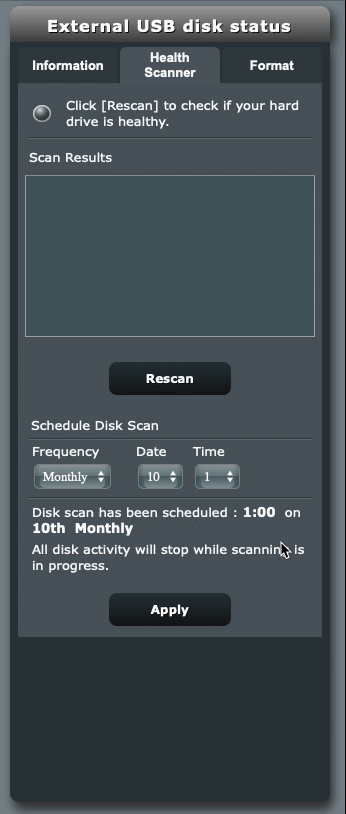

After you formatted your external disk EXT4, is the Health Scanner still able to check the the integrity of the filesystem? In my case, everytime I run Health Scanner on the attached EXT4 partition, it finishes way too quick without printing out any log. I doubt if a integrity check is performed at all.

Mine does the same.
Also EX4 is a journaled File System, so the integrity checks should be super fast anyhow.
I think its all working fine.
