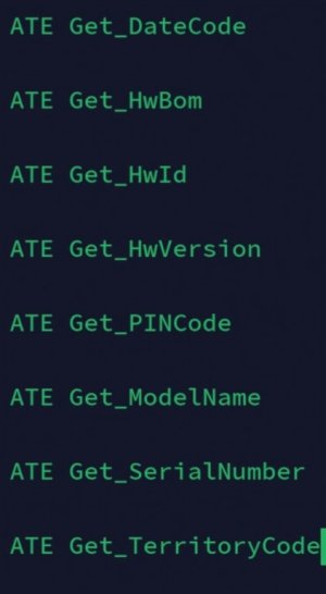

If you SSH these commands and they end up returning nothing for each, then your router was hacked or zombied somehow and needs some reconfiguring:
ATE Get_DateCode
ATE Get wBom
ATE Get_HwId
ATE Get_HwVersion
ATE Get_PINCode
ATE Get_ModelName
ATE Get_SerialNumber
ATE Get_ TerritoryCode
