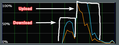

I have a 50/50 connection, when I use OpenVPN, that changes from 50/50 -> 20/50
I traced the problem to the CPU. For some reason, when it downloads, it only utilizes half of 1 core (I know OpenVPN is an inherently single-cored process). For upload, it uses all the core - which btw results in insane buffer bloat, but that's beside the point. My question is why does download use only half of 1 core's resources while upload uses the whole thing, clearly resulting in higher speeds. I know for a fact that it's not a network bottleneck since I receive 50/50 to the same server using OpenVPN's windows client.
If there is any script that I can run to force it to use all the resources it can, I'd appreciate if anyone lets me know.

I'm 1000% sure of the server, it's definitely capable of 50/50 and much more. It's my own VPS, I know what it's link speed is, it's around ~1.3 Gbps symmetrical. But I've even tried using several NordVPN servers. They all return the same result: 20/50. I also mentioned in OP that the OpenVPN client on PC connects with full speed, so it clearly has to do with the router.

Too late ;) But this confuses me even more now.
Edit: Speedtest was a bit inaccurate, so I tried using a download accelerator. Results are a bit more clear now.
Core 1, 3, 5: 4.0 MB/s
Cores 2, 4: 3.0 MB/s
I don't have a consistent way of testing upload so I guess we'll have to go off the speed test numbers.

Sorry if I'm being slow here, but what does that have to do with the discrepancy in upload and download speeds? I've tested this router on a 1.5G/1G Bell FTTH connection as well, it gave me the same results.
