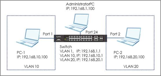

Does the Zyxel do layer 3?
Yes but probably more basic compared to your Cisco. The Zyxel is listed as “Layer 3 Light”. So no stuff like load balancing etc, and for you more importantly inter VLAN routing.

It seems strange you have static routes but no interVLAN routing. You really need interVLAN routing to use L3 switching. Otherwise, you require a router.
Ok, why don't you test it. Use my method to set up L3 switching. Then we will know for sure.
It is posted under one of the pfsense threads. I just posted it a few days ago.
I don’t wanna take down the network at my parents place right now. Additionally my understanding of networking is not at the same level as you or some of the others here so I will try it when my father doesn’t have stuff running, using your advice.
Edit: got some time now, stuck at last step from the instructions below as the last page is missing from the XS1930. I only have a couple of days before I leave for my own home so I’ll try to get the testing done before then.
Instructions, supposedly valid for the XS1930:
Edit 2:
This may work, seems I don’t need that last step in the other instructions, will try tommorow or day after:
Edit 3: Seems to have worked.
