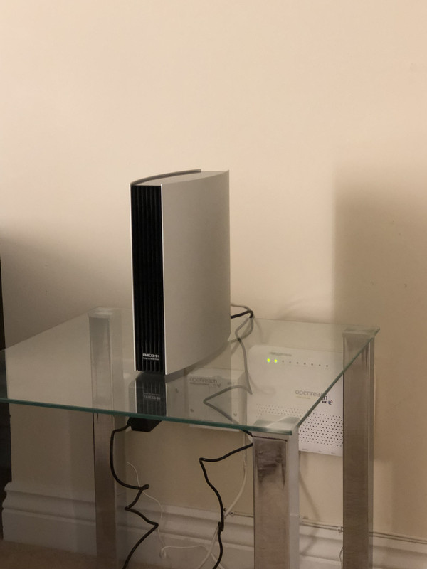

Received the K3 (b1 hardware) a few days ago and have been using it on my 330 Mbps FTTH line. My impressions so far:
Positives:
- Great build quality, looks great, not too big. Probably the best looking router out there.
- Firmware is pretty slick. Everything works as it should, making changes take effect immediately.
- Firmware has VPN client built-in and when I used this with my vpn.ac subscription, I got around 150 Mbps on a L2TP connection, so no issues there.
- Comes with a 100-240v power supply so can be used worldwide (I am in UK)
Negatives:
- Has only 3 LAN ports. Not an issue for me but I suspect for many, that will be too low.
- Wifi range/coverage isn't that great even with beamforming & Mu-Mimo switched on. In my 4 bedroom home with wafer thin walls, wifi speed tests on my iPhone X go as low as 150 Mbps in the farthest corners. Yet both the Netgear R6300v2 and Linksys EA9500v2 give me the full 300 Mbps on my iphone no matter where I am in the home.
I think I will keep the router because for the price I paid - £80 - its not a bad router at all. I will probably keep it as a spare router (eg for testing) and may use it again if/when Phicomm update their firmware (last one was from April 2018) to see if wifi performance has been improved.
Hope this helps :)
Ok an update: have re-plugged the K3 in and changed to wifi channel width to 40MHz and 80 MHz on the 2.4 and 5ghz bands respectively. This has improved the wifi speeds, almost on a par with the EA9500v2. I will keep using the K3 as its far more living room friendly = wife friendly :)

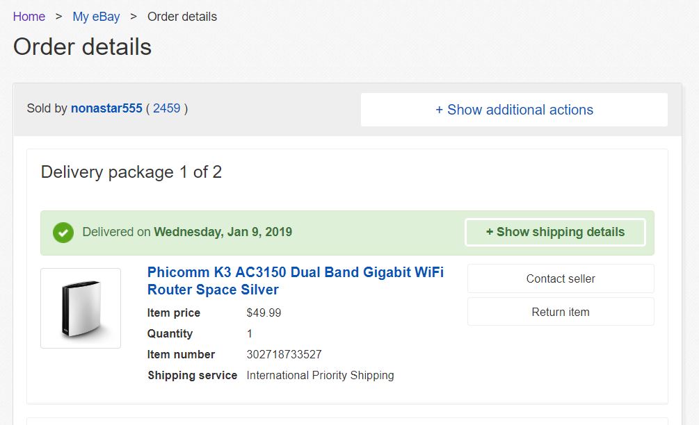

I bought mine from ebay seller nonastar555 for $49.99 but I've noticed the seller has jacked up the price to $102 now. Cheaper to buy it from amazon.com for around $80 at present.
