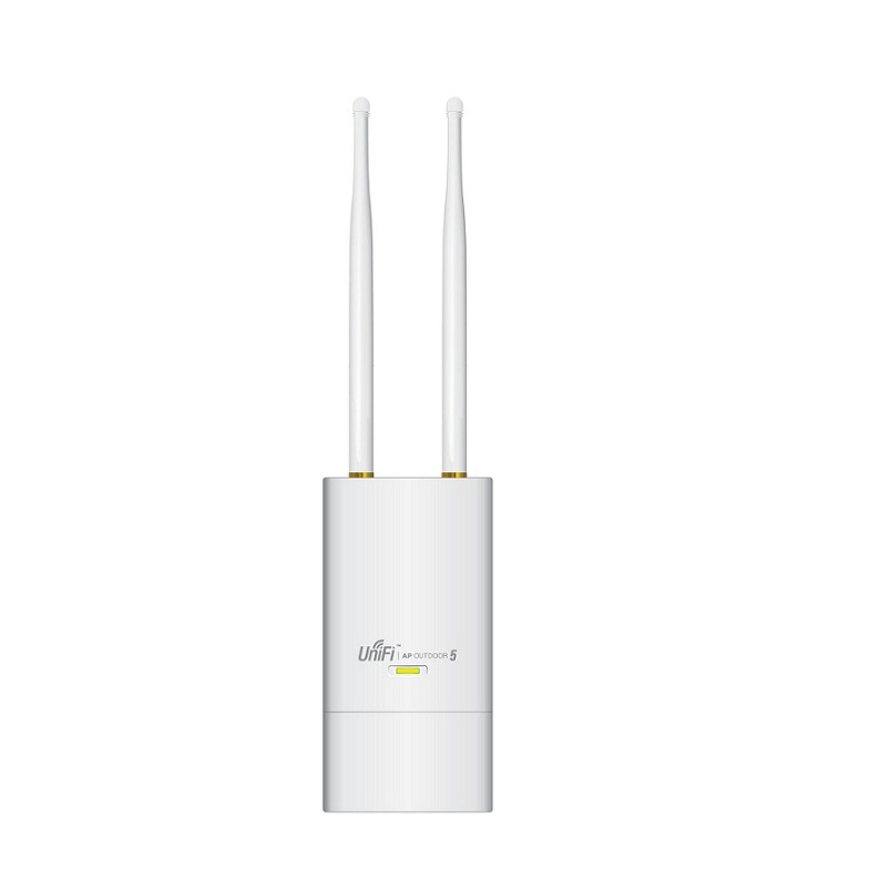

They were 'recognized,' as in they show up in the network topology with the correct device names (e.g., "Unifi AP5 outdoor"), but they were *not* adopted by the controller (which makes sense because they're already controlled/standalone). We're running 2 Unifi AP 5GHz outdoor units and 1 Unifi AP 2.4GHz outdoor unit (all purchased between 2013 and 2016).
I don't want to control the existing WAPs with the CG Ultra, so this result is perfectly fine.
ETA: they all essentially look like this.
