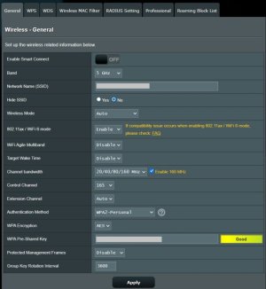

For a few days I disabled the AX mode on the 2.4 band and it seems that until now I can print on my windows PC (till then the printer was always offline), but still can't print from some android devices.
It's strange that on android devices from which I can't print, if I change the randomize MAC option to MAC phone I'm able to print for a few days, and then back to the same problem. The printing issue has been bothering me for almost 8 months and still no solution.
Regarding the loss of connection to certain devices (my wife's Samsung tablet), after I deactivated the 160 MHz frequency, I no longer had this problem.

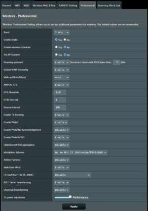

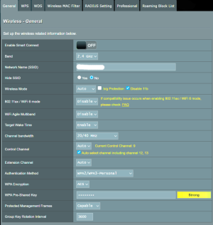

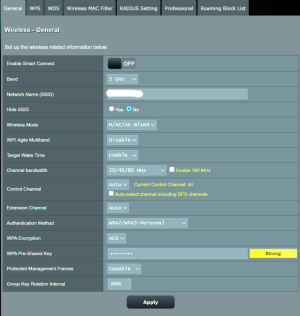

Made the move from a RT-AC68U to a RT-AX86U Pro last year and don't have any issues on Windows PC's (wired or wireless) or Android devices printing to an HP Officejet printer connected to the RT-AX86U Pro's main LAN WiFi. The printer has a manually reserved IP address on the LAN > DHCP Server page. The printer is connected to the main LAN 2.4Ghz WiFi. Android devices are connected to 5Ghz main LAN WiFi. The RT-AX86U Pro is running Asus-Merlin 3004.388.6 firmware and (not sure it matters) the YazFi add-on script for Guest Network WiFi. Don't have IPv6 enabled within the router GUI.
Couple of suggestions. Some of which it appears you may have already tried.
Reset the printer and reconnect it to the WiFi.
Set a manual IP reservation for the printer on the router GUI LAN > DHCP Server page.
Delete the printer entry on each LAN Client (both mobile and PC), reboot the client device, then re-add the printer.
Do not connect the printer to the Guest Network WiFi.
Avoid using WPA3 if any WiFi clients do not support it.
If one is having trouble with a Amazon Fire HD tablet finding or joining the 5Ghz WiFi, note that Amazon Fire HD tablets may have a restricted number of channels it can access on the 5Ghz range. Reconfigure the 5Ghz Wifi to a channel in the following channel range: channels 36 to 48 and 149 to 165.
The 2.4Ghz WiFi and 5Ghz settings that work for my use case and HP OfficeJet printer on a RT-AX86U Pro attached.
