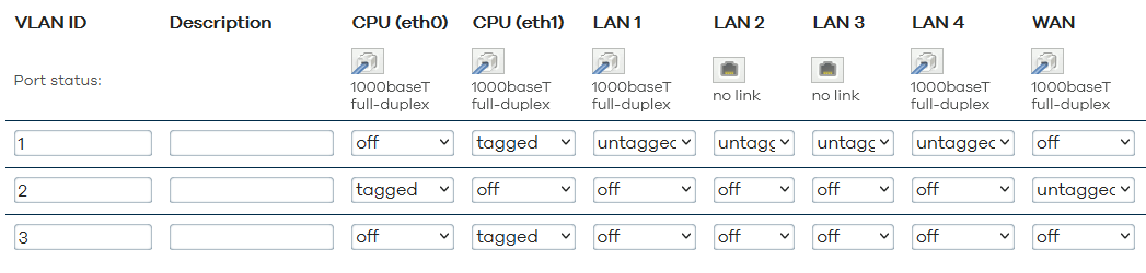

I'm currently using three VLANs with OpenWRT firmware and cannot see a difference.

Thinking about this more, I don't think it's the switch, or at least not the switch the way I was thinking. It looks like there is only a problem with WAN performance. I don't think the switch connects the LAN ports and the WAN port. The traffic between the two has to go though the SoC since it wouldn't be much of a firewall or router if it just switched LAN traffic to/from the WAN. The switch chip has 5 ports and 2 links to a SoC. So those two uplinks are ethlan and ethwan. The WAN port is just connected to the ethwan link and the four LAN ports are switched with the ethlan link.
It's still one switch, so there are buffer resources shared between the wan and lan side, even if they are basically two different networks. But if that was the case, then it should effect LAN traffic too.
I think from your description that you can have your server (1) send data to the 100mbps clients and then have a 1gbps laptop (2) test WAN performance, while the server is sending data to the LAN, and WAN performance is fine for the laptop. But if the server WAN performance was tested, it would be bad.
Try this test:
Have the server stream to the 100 mbps clients in all tests. Server is connected to gigabit switch connected to R7800.
Then try 1), WAN performance on server (which we know is bad already). Then 2), gigabit laptop directly connected to R7800, while server is streaming to 100 mbps clients, which I think you've done and WAN performance is good. And finally 3), gigabit laptop connected the same gigabit switch as server. I don't think you've done this.
It makes a difference because in test 2 the WAN traffic is on a different R7800 switch port than the 100 mbps lan traffic, but in test 3, it's on the same R7800 switch port.
