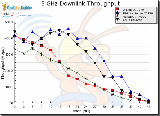

I would suggest the TP-Link C3150, it's got great coverage and speed on 5Ghz band. I also have a MacBook Pro with 3X3 and using the C3150 I've run speed tests over WiFi averaging 700-800mb/s. I'm also running PF sense and have the Router running in Access Point Mode, and I haven't seen anything else that can do those speeds over WiFi.
Nice, thanks for the recommendation - those are really impressive speeds. I hadn't been looking at rates higher than AC1900 as I thought that was the maximum that a 3x3 card could handle. But maybe it's also a question of CPU limitations on some of the slower devices.

You're correct the C3200 is dual 3x3, but I would suggest getting something 4X4, even though you don't have any devices that use 4x4, the extra antennas help older 3x3 devices. If you look at this graph you can see 4x4 makes a big difference over 3x3:
Here is a chart for the C2600:
b_550_0_16777215_00_images_stories_wireless_tplink_archer_c2600_tplink_archer_c2600_compare_5ghz_dn.jpg
Looking at this chart the C2600 doesn't have the same WiFi performance as the C3150, even though they are both 4X4. If you can't get the TP-Link C3150 then I would suggest the Asus C3100 which is similar to the TP-Link C3150. Both the Asus C3100 and TP-Link C3150 use the same SOC/WiFi components, so the performance is very close.

Yes, even old 2x2 or 3x3 devices show a benefit from 4X4. Your MacBook Pro which is 3x3 will show an improvement. I also have a 3x3 MacBook and it is much faster on the 4x4 C3150 vs my old Asus 1900P 3x3.
