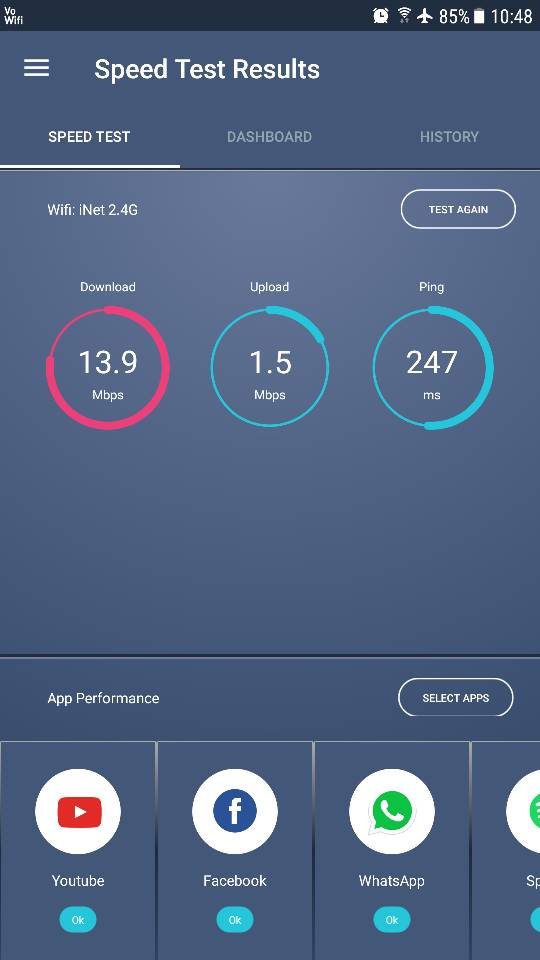

I don't know why, but with 382.xx series my wireless speed/latency is terrible on the AC88U.
Now I'm running 382.1_2 with mu-mimo, implicit bf, and AF off and I cannot reach my full speed.
With 380.68_4 or 380.69 works just perfect.
Sent from my SM-G935FD using Tapatalk
I had the same speed issues on my ac3100. Worked fine for a bit but then I noticed speeds were terrible (I was running for a few days and am not sure when the speed issue first started). I flashed back to 380.69 and its great.
Yes, in my case it lasted less than 10hs.. flashed it last night... working great and this morning issue was there.
The only workaround is rebooting device every time it appears.
