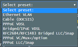

Thanks for the amazing work you are really awesome! I just updated my AC68P on the fly and so far so good... will report if something is wrong... I'm just wondering about the new QOS settings... what does each option means? Im a noob on this and would like some guideance... I tried googling but all docs are way to technical do you have something easy to share?
I've had similar question earlier in this thread, but haven't received any replies:
It's indeed highly technical, and myself I only partly understand it as there are no good documentation on what the traffic overhead exactly is in iproute2's commands. If in doubt, just leave everything to default settings.
