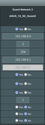

I wonder if anyone has had a chance to try and get Adguard to work with YazFi Guest?
No matter what I point the DNS entry to, I get 'no internet'. Work fine when Adguard is uninstalled.
I've tried using the router guest IP as the DNS, tried the router LAN IP, tried outside DNS servers. Nothing seems to work
Edit: using adguard installer 1.1.1 and Latest version of YazFi
Edit#2: Problem was with VPN redirection :)
so say for example your using 192.168.7.0/24 as your address subnet for guest clients. You need to put 192.168.7.1 in the DNS server slot and tell yazfi to enforce the dns. for example

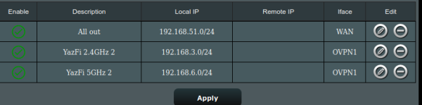

I had that, my VPN director rules seem to have broken. I'm testing right now to see if I can get the VPN rules back and the turn the redirection back on to see what happens.
refresh your browser and re read the post because I added more possibilities to try.
Routing through VPN works, YazFi directing to VPN and using the router as DNS works, BUT, I'm getting ads.
I.E. I pick an app, open it, there are ads. I close the app, I switch to the LAN network, no ads.
I'll do a reboot and do some more testing.
can you screen shot the settings that allow you to use AdGuardHome, but no ads. , also you probably have to tell the VPN server to Advertise No DNS, otherwise you could be use both the DNS of AdguardHome, and the vpn server.
The LAN network works consistently (it's the default rule in VPN Director)
The settings I screenshot above are unchanged.
What I'm wondering is if I need to change any interface settings in AdGuard itself for the 192.168.6.0/24 network.
I am pretty sure what is happening is your VPN is using its DNS along side AdGuardHome. So you are not seeing the blocks of AdGuardHome, because the looks of clients are going to both AdGuardHome and the VPN. Tell the VPN to not advertise itself as DNS. Set Accept DNS configuration to disabled.
That was it! :)
The VPN DNS server rule i am pretty sure were maybe even adding iptable rules which made your clients circumvent using AdGuardHome for DNS, especially if they came before the ones for the YazFi guestnetworks, But I am not too sure about this aspect. But at least I was correct that clients were using the VPN servers DNS instead of AdGuardHome.
