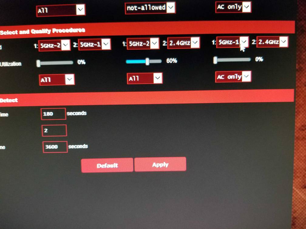

I have found SmartConnect to be garbage after some testing. My Note 8 connects to the 5Ghz-2 correctly but for some reason my Samsung Curved 4K TV which is in the same room as phone is only connecting to 2.4G 144Mbps. I had it on 5Ghz-2 before at 867Mbps. What gives?

Tweak these settings.

Most of my devices stay in the 5ghz-1 band then when utilization is met it rolls over to 5ghz -2. Exception is that if the signal is weak it will downgrade it to the 2.4ghz since there is greater distance on that band. If you set a phy over under it will keep devices of a certain speed on certain radios.
Setup mac filtering I had to do the same with a DirectTV STB to force it to stay on the 5Ghz Band stuff like Smart TVs and STBs don’t know how to handle bandsteering
Heh I set it up for 5Ghz-2 accept and then rebooted router. It connected to 5Ghz-1 at 866.7 Mbps LOL. Wonder why it didn't even goto the 5Ghz-2.
I'm not. Even my Note 8 connected to the 5Ghz-1 instead of the 5Ghz-2..

Way I understand how 5Ghz works the lower bands 36 to 48 are faster than the upper band Channels on 2 but they reach out further
