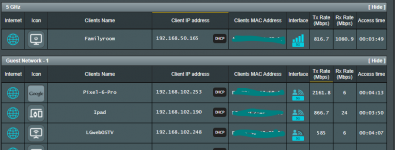

I have it set to AX and set to 160 in the drop down. Clients that can connect at 160 do, and the rest adjust to what they can do. I'm surprised by the ipad, its pretty old.
I wouldn't lose site of actual throughput, testing at the app level on the client (speedtest, etc). Adjusting for speed at this level doesn't change a whole lot, at least for me. That older Familyroom windows workstation at the top won't use half of the 1GB posted, not matter how I set 5ghz settings. And the Pixel smokes the lot of them by far... 600mb service and its clocked over 700, again, 5ghz settings don't really change that; I guess it depends on the ISP service you have.
